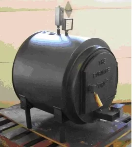

Our first boiler (non-gasier) was like the one pictured. It burned 22 cords per year. This is what most outdoor boilers look like before the little metal house is built around them.

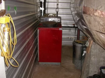

Our second boiler (no picture) (non gasier) was a triple pass cast iron down drafter which burned 16 cords per year. When 1,046 imperial gallons of storage was added, consumption dropped to 10 cords per year.
[Hearth.com] CANT DECIDE BETWEEN REGULAR OWB OR OUTDOOR WOOD GASSER
30+ years ago when our Jetstream was connected to the same storage, consumption dropped to 4 1/2 cords per year.
From my experience, storage has really allowed our gasifiction boiler to work at very high rate of efficiency.
