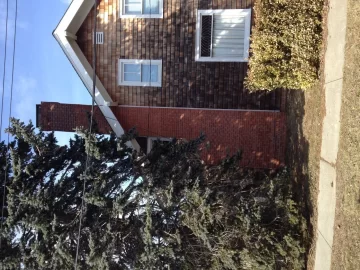

Thanks for all that info so quickly ! I have attached a picture of the chimney and its approx. 30' tall. I am sort of hedging to an insert, possibly the PE neo 2.5 insert. I don't think I want too much sticking out of the fireplace.
For an exterior chimney we highly recommend an insulated liner. With 30 ft you will not have problems with insufficient draft; in fact you may even need to be a bit careful to not get too much draft. Is the chimney wide enough to accommodate a 6-inch liner? Since the back of the fireplace borders the outside you should consider putting some insulation behind the insert to keep more heat in the house. Here is an example: https://www.hearth.com/talk/threads/got-the-itch-again-jotul-c450-kennebec.120801/ I also highly recommend a block-off plate to keep the heat from going up the flue: https://www.hearth.com/talk/wiki/make-a-damper-sealing-block-off-plate/
