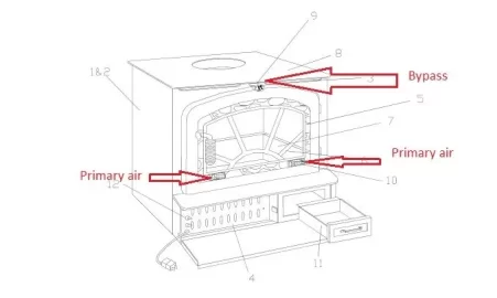

Anyway, looking at the manual here is what I see. You have a damper handle at the top which is the bypass, and at the bottom you have those two air controls you mentioned.

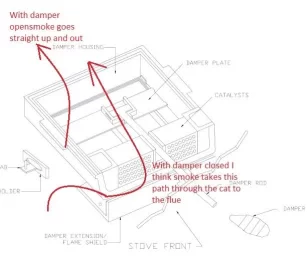

Looking further down I found this diagram of the damper. Looks like pulling the rod out is full bypass which lets smoke go straight up the flue, and pushing it in routes the smoke forward through the catalyst.

This is what i would recommend:
Cold stove:
1 Pull damper rod out all the way to fully open
2 Open both air controls ("draft") fully
3 build your kindling fire
4 Once it gets going well add a couple splits
5 Once the stove top thermo gets to 500F, push the damper in fully to completely close it, then leave it closed
  • In a few minutes the cat should light off and the stove top temp will probably continue to climb
6 Now start slowly closing the primary air vents until you get thestove to your desired cruising temperature.
  • As you close the air the fire in the main box will die down, but the catalyst temp will rise as its burning off the unburned smoke. Since your catalyst is mounted right under the top plate, you should see the top temp rise. It may actually go up as you close the air (counter-intuitive)
Try this routine with good dry wood and let us know if you get better results.
