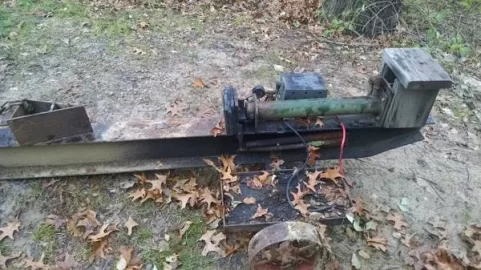

(broken link removed to https://quadcities.craigslist.org/grd/5349934255.html)
[Hearth.com] car battery log splitter
Interesting, That appears to be a screw jack if i am looking at it proper. I would guess pretty slow.
Interesting for a wood splitter museum. I would look for something newer.
The seller says it has a leaky cylinder.
I see in the add that the second pic does show a hose going to the rear. Good catch.
I can't see this as much of a production machine.
Well a plow on a pickup truck has a lift cylinder about that size and is often cycled every minute or so. Might be fun to play around with if you only need to split a bit for Sunday afternoon fires....
If the price is right you at least have a few components...
A plow pump runs maybe 10 seconds to lift or angle and it's still very easy to discharge a battery with frequent lift and angle cycles.
