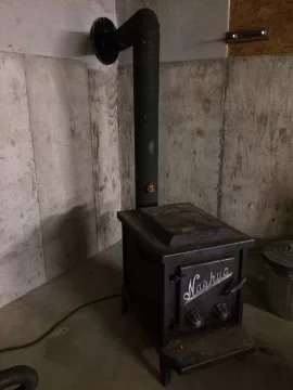

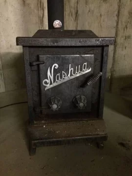

Hi, relatively new to heating with a wood stove. I moved into a new house a couple months ago that has an old Nashua wood stove in the basement. I've been burning wood for the last few weeks as the temperature drops.
For safety, I have a combination CO/smoke detector in the basement and a Kidde CO detector with digital readout on the first floor.
The issue: the Kidde CO detector on the first floor is showing trace amounts of CO. The actual display won't show anything, but when I hit the 'peak level' button, I'll see reading between 20 and 30 ppm. This normally happens when I've been running the stove over night or for a long period during the day. From what I've read, this isn't enough for it to trigger the alarm (it would have to be 30+ ppm for over 30 days!), but it's definitely not healthy to be breathing this over long periods of time.
Normally, I wouldn't be too concerned about these trace readings, except I have a newborn in the house.
Pictures of the wood stove installation are below. Any help would be greatly appreciated! I'm thinking about swapping out the Nashua wood stove for a Lopi Liberty that is also in the basement, but not currently hooked up.

It's good you are monitoring these levels of CO. Do you know if the elevated levels are occurring at any particular point in the burn cycle, like maybe towards the end before reloading? If they are then the Liberty may have the same issue, though it will be a more efficient burner.
Basements have a tendency to be negative pressure zones. My concern is that draft may be neutral or reversing slightly at times. I'm not sure if this is when the flue gases are cooling down, or when an exhaust fan (bath, kitchen or clothes dryer) or other air source competition (furnace or gas hw htr.?) kick in. You will have to do some testing to figure this out. Is it possible to crack open a window a little bit in the basement for a few burn cycles? It doesn't need to be much, a half-inch will do for the test. That will introduce an outside air source in the house.
Also, if this is 2 story house, look for air leakage on the upper floor. This could be an attic door seal or leaky window. The exhausting of air at the top of the house can increase negative pressure in the basement. Also check the sealing of the stove pipe into the flue thimble.
To assist draft you could try replacing the 90º elbow with a pair of 45s that have an offset between them so that the top 45 connects directly to the thimble.

Begreen mentioned the first things that popped into my mind inc basement and maybe changing out that 90. You want to do whatever you can to promote draft. From the picture it actually looks like the horizontal run is higher on the stove end (even level is not ideal). How is the rest of the chimney (how long and type)?
If your air is too low and your not sending enough heat up the chimney to keep it warm that can create slow draft and as the fire dies draft can collapse. You have at least a couple negatives right off the bat (90 and horizontal run, poss basement issue) so correcting the chimney and sending more heat up the chimney may overcome the problem.
