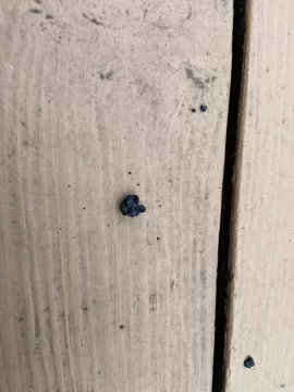

Hello all,
This morning while outside, I found a number of these small (peanut sized) carbonous nuggets outside on the deck, next to the chimney. There’s probably about 2, 3 dozens of those scattered in the immediate vicinity.
What are those?
[Hearth.com] Carbonous droppings near chimney
Expansion and contraction of your metal (assuming) chimney liner or pipe loosens up creo and the draft carries it up and scatters it about.
It could also be evidence of a chimney fire. Not nessecarily but it is possible. You should definitely check everything out
😲 and I just cleaned the chimney with soot eater a few weeks ago, too! Barely a handful of dropping came out.
I'll take a look at interior this weekend. The chimney exteriorly looks fine.
Since moving in I have yet to remove the chimney cap area - I think that's where the creosote might've came from. It looks like a bit gunky.
Soot eater will not remove glaze creosote. Unfortunately, it’s the glaze that catches.

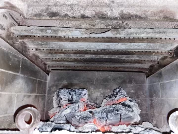

Shame on me for not noticing... I got a crack down the baffle plate earlier.
For some reason the first (nearest to door) secondary tube was consistently popping out of position.
i clean with a soot eater as well. I get pieces of creosote stuck around the cap, when they get numerous i know its time to clean. I get these pieces post soot eater clean for a couple weeks as they are dislodged from the cap. They accrue on my roof and wind, rain, etc will bring them down over time in the next weeks.
Are those "tubes" welded in? What stove is that?
I got a chimney sweep coming upcoming Tuesday for a full clean + safety inspection.
VC Montpelier. The tube rests in the holders and 1 single cotter pin prevents the tube from sliding around. If the cotter pin is sheared somehow the chimney sweep should be able to replace it next week as well.

I get accumulation on my cap, the sooteater knocks it loose and it winds up on the ground.
That said, folks like bhollar are pros and I listen To them.
