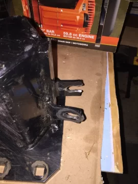

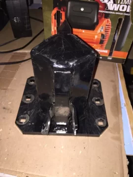

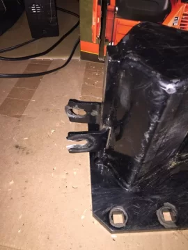

Ariens 22 log spitter. The wedge got stuck in a log and the log got stuck in the teeth. I tried to back the wedge out and carnage insued. I never imagined i would see the day that there was wood that the splitter couldnt handle. Knots are not my friend.

30 minute repair, if you have an angle grinder and a welder. Unless your dealer is alarmingly close to your house, I'd not be wasting time to even start the car.

You have just discovered why I don't care for that design. The bolt and tabs that are used for the return of the wedge is a weak point.
I wouldn't even bother making the phone call. I would locate some 1/2 in flat stock for the repair and "over-build "that repair.
I was told by Ariens that the new version of this part fits the same but uses a different type of metal and is shaped slightly different while still fitting. I noticed that the metal tabs are slightly thicker on the new version.

I think you would be far more satisfied if you took it to your local welding shop and have it done right. As easily as that tore apart I would want something more than slightly thicker to replace it.

I would be kind of leery about why that happened. The lever should have kicked off well before it got to that point.
Well, I guess - unless you were holding the lever back, maybe? In that case, mine just has a single bolt holding the wedge, thru the end of the cylinder. Not sure how much it would stand.
Thanks. Considering that as one of my options. Was concerned with making it too strong if that was the design point for it to give there?
I was holding the lever trying to remove the wedge from the log. :(
That was a design flaw and not a built in safety feature. They should never fail at any point.
