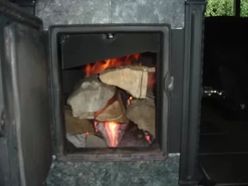

Well the huge majority of primary air is dumped in via the airwash at the top of the glass and there is also a small hole at the bottom front and center for "zipper" air but neither of these make the heritage a N/S burner. Fact is the heritage is very shallow in that direction, maybe 8 inches? You just can't fit normal sized splits any way except in the E/W orientation.
The mansfield is about the same width but deeper allowing for N/S loads. That's a pro in the manny's favor. Plus we have a beer here in the NW called Manny's pale ale from Georgetown Brewing Company that is excellent. Major pro in favor of the mansfield stove.
When I load the heritage I don't mess around. Fill her to the gills. So as snowleapord points out, that method is likely to put ash near the glass which means that ash will pack the front door seal and dump onto the hearth when I open it every few months.
