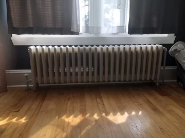

I am looking into getting some TRVs for some CI rads that are early in the run.
My rads have hot entering on the top right and return on the bottom left that has a manual control valve. Pic attached.
I have read that TRVs should be on the hot side, is this the case?
Should I get the manual valves replaced with TRVs or get the TRVs put on the hot side?

My TRV's are on the hot side,plumbed hot in top cold out bottom.
They work great,set and forget.

Yes it is a beast, and there is another one just like it on the other side of the living room... as well as a wood insert haha which is why I'd like to get TRVs put on these. The brand is Corto.
