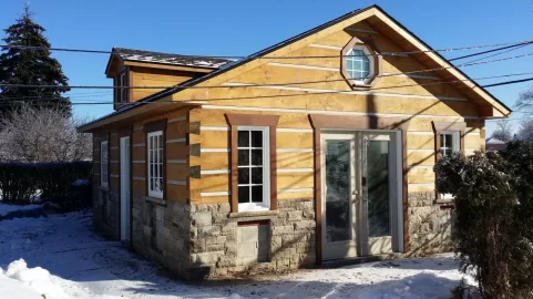

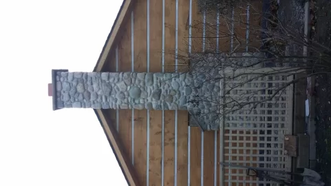

Here are a couple shots of the new hearth
[Hearth.com] Cast Iron Stove in Outdoor Workshop- Problems??

What is with the beam going through the upper part of the chimney? How is this isolated from the heat of a fire or more importantly many fires?

The 'beam' is just a 2x4 brace wrapped in boards. It's about 8 feet from the opening of the fireplace so I didn't think it would be a problem. It's anchored to a stud behind the stone facade. No contact with the actual flue pipe if that's what you were thinking.

A proper chimney should have 1" clearance from all combustibles. Heat is transmitted through the stone fairly well.

What is going in the cement block openings below the windows?

Haven't decided about that yet. Was thinking some sort of decorative wooden inlay. Faux doors maybe.

That is some nice log work there. Full dovetail notch, very unusual. Nice.
