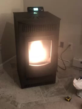

Newly purchased a Castle Serenity over the weekend. Still figuring and fine tuning the unit. Set the weekly mode to come on before we woke this morning. Guns blazing at 5am this thing was going strong on speed five. It went down to one for a half hour. Then blazed back up to five. Is there any way on weekly mode to control the number the unit works at?

  • [Hearth.com] Castle Serenity- Control Unit while on Weekly?
