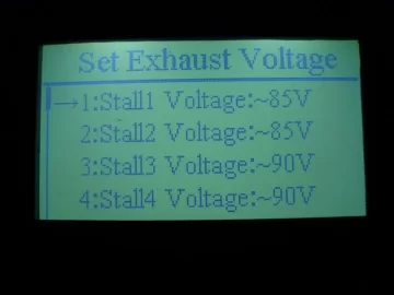

My north stove settings.

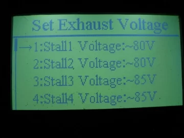

Though both the north and south stoves are identical, the south one has a better blower or something as it does not require quite the voltage that the north one does to get the same results.
South stove settings.
