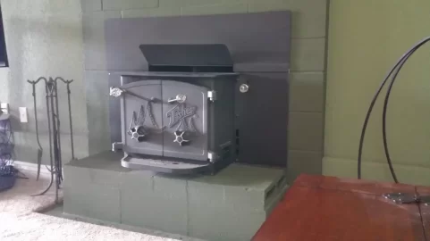

I currently have a old fisher in my basement that I use in my house but in the process of buying a insert for the main floor. I went to the local wood stove seller and they were recommending me not to buy a stove with a cat due to wood that's available in the PNW it's mostly soft. they sell BK, enviro, PE, and regency.

The company is coming in on Friday to do a sweep and take measurements so hopefully I can start looking at inserts of course I will put up a thread on here. This place has great knowledge. I myself am undecided on a cat or not. I barely get any smell of smoke with my 30 year old fisher. I really like both the BK and the PE.
In insert land your options are limited. Is your fisher an insert? I've only seen freestanding fishers. I would always recommend a freestanding stove over an insert if it is possible. The only BK insert is the princess and does not have as much firepower as a big grandpa bear fisher. The PE summit insert is well liked. How big is the home?
Yes my fisher is a insert. The fisher is staying in the basement and the new insert Is gonna go in tge first floor. Each floor is a little over 1000sqft
