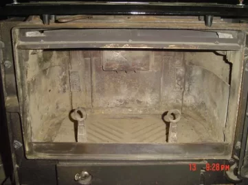

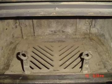

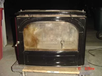

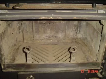

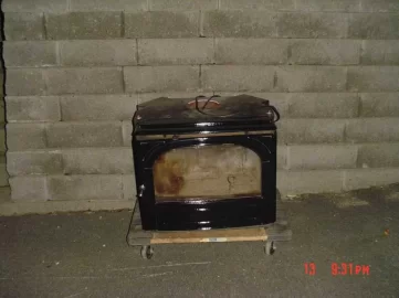

It looks like a small winterwarm....
Not a powerful heater, if so.
Also, blower and electricals should be checked out as they are on the rear of the unit (I think).
Unit does not look abused, the orange on the inside rear is somewhat normal since the flame is sucked up through there - but it would be wise to check the cat converter is this is the right model (WW).....
Never was my favorite insert - more about style than heat
