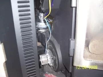

How did you fix this? Was it a leak from the door? Or from the actual blower? Here's what mine looks like.

Mine was from the main door seal. The 2 hinges seen in your picture (attached to the big door with glass windows) should have some adjustment slots. Loosen them up one at a time and tweak them just a little. Of course you'll have to be careful not to make it so tight that the door flexes and breaks your glass...
