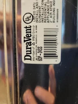

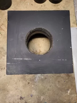

Getting ready to put in my VC 1990 and have questions about the support box. I have the Duravent 6DP-CS11 box not installed yet and the Duravent triple wall that goes above that out the roof (pictures below). I would like to use 6" double wall pipe from the VC stove to the ceiling then the box accepts the triple wall already on the other side. It seems like the box will only accept single wall on the inside ceiling side. What am I missing here? Is there an adapter that I need? I do not have the double wall pipe ( only have a few pieces of Ameri-tech DCC and can't find anymore). I will probably go with double wall duravent. I am mainly using double wall for clearance purposes

DuraVent provides a couple of options.
[Hearth.com] Ceiling support box for my VC
It looks like that first one may be my option. It's hard to tell from the picture but looks like it will go into the ceiling box single wall and convert to double wall down to the stove correct? Any opinion on 6" double wall that won't break the bank? Also from what I read it looks like I need a different adaptor also on the VC 1990 to use double wall correct?
Both will work for double-wall DuraVent DVL stovepipe. The upper one will also work for single wall DuraBlack stovepipe.
I'm not sure if any adapter is needed to connect the stove. Some don't need it. It depends on the flue collar.
I wish they would show a picture of the top of it. So you say the top will fit into the single wall connection of the ceiling box? And your saying the bottom will fit single or double wall to the wood stove? It's confusing without a good picture especially for a part like an adapter
The support box receives the adapter. It is inserted into the support box hole and then is screwed to the box. This provides a starting flange for the stove pipe.
