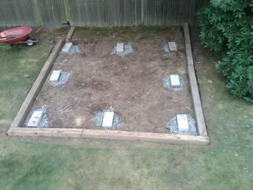

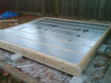

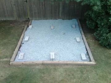

It may be worth some time looking at this video http://www.hotandcold.tv/frost_heaves.html It isn't about slab construction but it does discuss frost heaves. A shallow slab under the shed is a prime candidate for frost issues so anything you can do to prevent heaving is going to really improve things. A lot of the prefab concrete buildings that utilities use like at cell tower sites are precast at a factory complete with floor and just set down on a crushed rock base. The crushed rock is not impacted by frost heaves unless its sitting in a low spot where there is standing water. I have done this on several jobs and it works well and avoids having to deal with insulating the slab.
I would not use quickcrete. Start with a compacted crushed rock base and then truck delivered fiber reinforced concrete is what I would use. The fiber crete is mixed in the truck before pouring.

I would likely try what you're thinking, but maybe on top of a layer of gravel or stone, after taking the top layer of sod & topsoil off.
I put up an 8x10 metal prefab shed a few years ago. I put 9 patio blocks down first - on top of gravel where sod used to be. (Kind of like Dons picture above but with 24" blocks & one in the middle). Was a big PITA getting them all levelled up, but once I did the rest went good. Put a 3/4" plywood floor inside after the shed was up. Or maybe it was after the floor frame was down but before the rest went up. That's where I keep the ride-on mower plus lots of other assorted junk. It's been solid ever since. Have some rust spots starting to show here & there, and a bit of a leak up top somewhere - but nothing to do with the foundational stuff.
