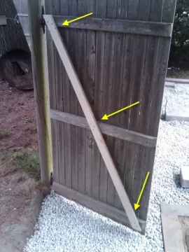

Well, the fence door was not right and very close to the shed base. So after thinking about it for a while, I said Let's Fix the door and include it in the shed base!!
So I dug it up and added weed block and stones. Then screwed a piece of scrap primed pine as a cross brace to keep the door from sagging!
If you click on the 5th pic below to enlarge it, you can easily see the 2 yellow arrows pointing to the nails sloping from right to left. That really shows how much the door was sagging!!!

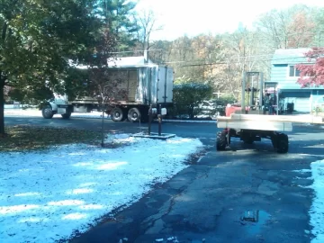

Finally, the materials for the shed shell has arrived!
