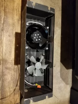

UPDATE:This may help some other people out. I have updated my Cemi to a dual fan blower. There is also a plug in Rheostat that will work. My rheostat was missing when I bought mine.

I will have to post pictures once I add the Boxer fan part number is 1BF2107. The C Frame fan part number is 1CFMS. You have to use one of each to make your Cemi a dual fan system. I found a Rheostat on Amazon Part #H9980 by KB electronics Dial A Temp for $20.00 that you just plug in the blower unit then I can control the fan speed to control the temperature better.. I have not received the fan or rheostat yet but I will post pictures once I install everything.

UPDATE: I received the new fans and rheostat. This is picture of the dual fan.
[Hearth.com] Cemi Concept II [Hearth.com] Cemi Concept II
Odd combo to have one fan framed and the other open.
I thought so too but that is how it shows in the manual.

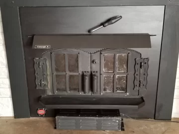

Would it be possible for you to share a picture of the handle that you use to open you door latch ? We are currently assisting a customer in a replacement handle and do not know exactly how the handle unlatches latch. Is it like a hex stove tool that inserts into the opening and turns latch?
What size ?

You are correct it is just a big hex head "L" shaped tool. I can take a picture later tonight and show you what it looks like.
