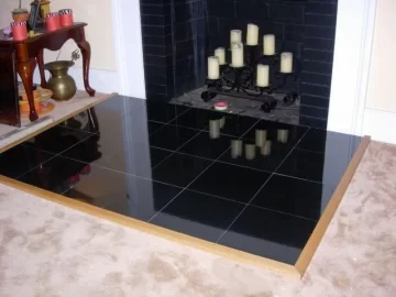

I just finished making a granite hearth to set my Fireview on. The granite and other natural stones are slightly thicker than the manufactured tile, but not that much. Natural stone does have some little stress fracture lines in it, and if your subfloor moves, they can crack easier than the other tile. Any tile will crack if it does not have a good base or the thinset is not correct. I loved the black granite and it did cost me an extra $4.00 per tile, total of $100 more. Hopefully will install the liner tomorrow and Fireview Monday.
  • [Hearth.com] Ceramic Tile vs Stone Tile
