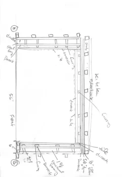

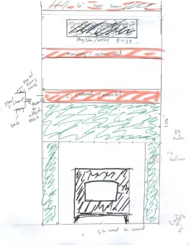

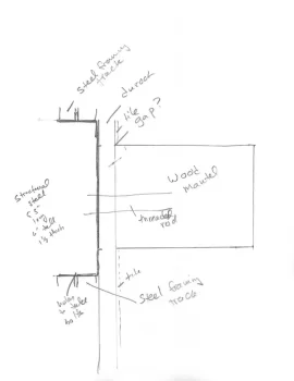

Hi Begreen
I have drawn up some sketches. There are two things I am worried about. First is if I can have a wood mantel or wood clad mantel, how to attach it to the wall. What I am thinking is to have a piece of 55" steel run horizontally at the height of the mantel. It will be attached to the wood framing on the outside of the firebox (I'll weld some tabs running vertically and use simpson structural screws to attach it to the wood. I am thinking I may need a layer of durock as a buffer for heat transfer between the steel and the wood). The steel will probably be 5 or 6" tall by an inch and a half deep. It will have holes on top and bottom to attach rails for steel framing (15/8", heavy gauge), which will be the front wall. The inside will either have one layer of durock or one layer and then a convection wall if that will help with the mantel. The outside will also have a layer of durock, which below the mantel will have a tile face and above will be plastered to match the rest of the room. The structural steel will need to also take the load of the mantel which will project. The easiest way to do this is with a cleat which the mantel will fit onto and then be screwed to, but I don't know if this will work with the possible heat transfer. I could have an air gap behind the cleat and have strategic holes in the mantel to allow air to circulate behind it. I am attaching three drawings. Thanks again

Great. Thanks for posting the pictures. The first one shows serious overkill on the protection for the walls in a standard alcove install. There is little to be gained past a certain point, but I can see you may be going by the Lopi manual guidance which has an additional layer of protection as compared to most stove alcove requirements.
The big issue is with the fireplace like enclosure that will trap a lot of heat, even with a top vent. This is not a standard alcove enclosure and not what the manufacturer tests for. The Patriot alcove design is for an 84" min. open front alcove. For certain the face wall would need to be 100% non-combustible construction, ceiling too probably.
