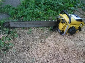

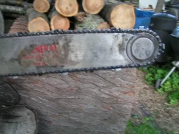

Mac SP125C with vintage late '60's General 30" rollernose bar & new .404 skip chain.::-)
