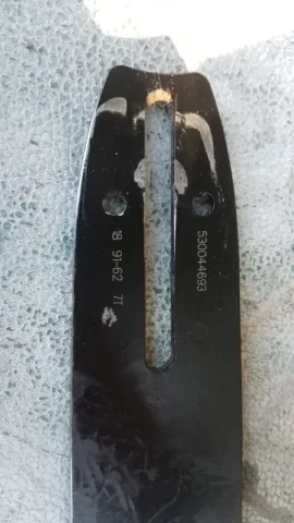

Remove the bar from your saw, and tell us (or post a picture of) the information stamped on your bar.
Attached is a picture of the bar. Its stamped 18 91-62 7T. Any help finding a replacement is appreciated.

Does your chain have the number 91 on it? My best guess on what you have would be Oregon 91 chain which is 3/8 pitch and .050 gauge. Count your drive teeth (inside teeth) my guess is 62 drive lengths. If correct you need Oregon (or equivalent) 91 chain - 62 drive lengths. Any saw shop could make you one, just bring in your old chain. Online would be Baileys or Logger Chain. Hope this helps.
18 91 62 7T
18" bar
91 = Oregon code for 3/8LP pitch, .050 gauge
62 = chain compatible with that bar has 62 drive links (DL)
7T = 7 tooth sprocket
NOTE: 3/8LP pitch is not the same as 3/8 pitch
Regardless of chain brand, a replacement chain for that bar will have the following characteristics
3/8LP pitch, .050 gauge, 62DL.
Replacement 18" bar will have the following characteristics:
3/8LP pitch, .050 gauge, 62DL, bar mount pattern that fits your saw.
A shorter bar will use require a chain with fewer DL>
How do you know which bar mount pattern fits your bar? The bar will be listed as being compatible with your saw's model number.
