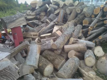

Solar those rounds look perfect for the King just as they are.SolarAndWood said:Thanks guys, I'll order some semi chisel for the next time. I'll sharpen some of the full chisels out of the discard pile. Hopefully, I'll get a few more loads out of there before it turns into a free for all this weekend. For those that demand proof that it happened, its the smaller diameter stuff in the foreground.
SolarAndWood said:Hey Rich. I crack them all in half even though they are about my ideal split size 8x8. Seem to dry better, stack easier, load easier etc.
