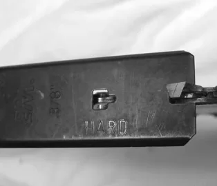

For anyone who doesn't know what a raker is or what it does, it's that little protrusion in front of the cutters. The rakers regulate how far down into the wood the tooth can cut. Without rakers, your saw would jam into the wood because it would take too much of a bite. The reason that rakers need to be filed down is that as the cutter is sharpened (becomes shorter), the raker level has to be adjusted accordingly. You do this with a special flat file that is smooth on the edges to avoid damaging the cutters when you slip.
Filing your rakers too far down can be dangerous, however, as too much bite from the cutter can stall the saw and send the bar back at you, aka "kickback." The rakers need to be filed to a uniform height, and NOT filed down too far. To determine how much to file, you use a simple tool called a raker gauge, which rests on the tooth and allows the raker to protrude up through a slot in the gauge. Here's a picture of a raker gauge in action. The "HARD" designation on the gauge refers to the slot because there are two: one for hardwood and frozen wood, and another one for softwood and non-frozen wood.
