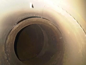

I found the problem. Now how do i go about getting this fixed? Take a look at this pic. The gap you see is the inside wall of the air insulated pipe.When i shut the air dowm i think it was drafting air from that gap and not through the firebox Causing the firebox filling with gasses and exploding. Now this seems to be an install problem but this is all inclosed in the wall. I hate to go to the person who installed this unit and expect them to fix this right. What do i do now? im not going to use this until it is fixed. Please give me some feedback and thanks for alll your help.

If I were you, I'd get a pro--chimney sweep or stove shop person--to check your entire chimney post haste. This may just be the tip of the iceberg--there could be other problems, and this might have been *caused* by your backpuffing, not the other way around.
My point is, we just don't know, and it takes a pro on site to make sure everything is right.
But I may be wrong--what do experts think?
But on the bright side, you're getting on top of things, before a fire started. You should have your chimney inspected at least once a year, and since you're having problems, probably every six months like your manual specifies. I'm sure glad that deferred maintenance didn't cause more problems than it has. All and all, it's an inexpensive lesson.
Is that an offset right in the top of the unit in the pic? It is kinda weird to see those screws in the pipe, I know this hasn't always been the case, but Duravent has special Travis FPX pipe that is to be used and it has no screws in the interior pipe. If that is an offset in the pic, it might not be supported properly and has settled, it should also have an adapter in the top of the unit, maybe they left that out.

Yes that is an offset. I looked over the install manuel and it looks like there shoud be 3 screws on the starter collar. I only see one. Im not shure if this is the starter collar. Something doesnt look right.
Wow, kudos to you for finding the cause of the problem! You should absolutely go to the installer with that pic. Having built and installed one of these myself, I know how daunting it is to think of opening up the installation to get at that particular part of the chimney, but what choice is there really? If the installer is a professional, they should have done it right to begin with, knowing that it would all be enclosed and virtually inaccessible. If they weren't professionals, were they friends? Did you pay them? Whoever they are, you have to get them to own the problem now.

I'd certainly get someone to come in and check that for you. if its up on top, couludn't you just get some high temp calk and close the hole. At the far end, the temps aren't that high anyway.

This was installed by a fpx dealer. This will be a nightmare to fix.

Experts--might it be possible for someone qualified to fill the gap with refractory cement or the like (thermal expansion could be an issue)?
Might that be an easy fix, as long as the fixer is qualified and makes sure the whole system is safe?

That happens more then people will admit to.
How do i find out what chimney pipe was used on my install? The only thing visible is the chimney cap.
