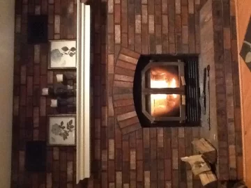

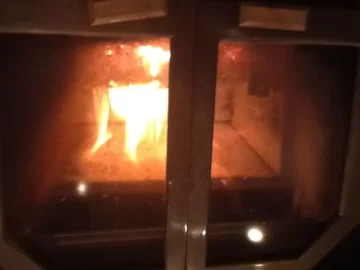

Let's start with some pictures of the current setup. I'm not familiar with the older BIS systems. Is there an air-cooled or class A chimney on the fireplace? Do you have a model number?
Photos of the existing installation would be invaluable...as would be info about the existing flue (chimney), and some idea of the fuel available to you. Welcome to the forums! Rick
Here are a couple pics, I will take more in the morn of the flu. I am burning ash, oak, cherry, and some maple. It looks to be a class A chimney.

That second picture really tripped me out until I saw it is upside down...
