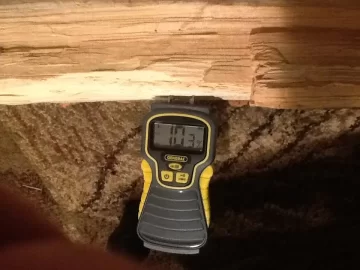

I am bringing the wood inside for anywhere from a few hours to a day to get it warm, then I haul it back out and split. Run right back inside and hit it with the moisture meter (prongs in line with grain on newly exposed surface). As a test I did this with some recently cut walnut, got 32%. My pine measures 10-12% pretty regularly.

10-12% sounds really low. It's really hard to get much below 15% in a lot of USA climates. FYI, kiln dried lumber checks in around 8%. The freshly cut walnut at 32% is possible, but that sounds low too.

The 10-12% seems consistent, the thing I don't get is that the wood that I bang together and get the crack sound that feels lighter seems to measure the same as the wood that goes thunk and is heavier at the same relative size. The walnut was standing dead to my untrained eye it looks like its on the way to dry. If I put the moisture meter on my hand and press I get mid 30's

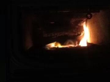

I closed down about 3/4 of the way in increments and for a few min had some slow lazy secondaries then lost flame. Now opening back up slowly I've gone pretty much to open and have lots of red glowing coals but no flames back.

Grabbed a 7" half round from beside the fire, split it open just now, inside is cool not cold digital food thermometer says 58.5 on the fresh split surface. Mm says 10%. Placed on my palm mm says 41.4%.
I'm absolutely ready to believe the wood isn't dry enough but the meter doesn't seem to back that up.

The more open the air is, the more heat going up the stack. Once you have a good established fire going, try closing the air back as far as you can.
Make sure you have a block off plate installed in the damper are of the fireplace firebox.
And make sure the wood is really ready.
