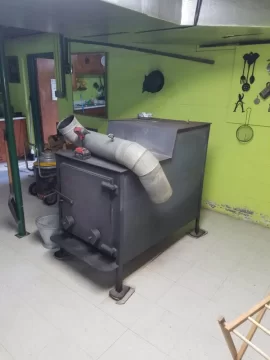

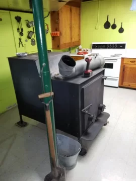

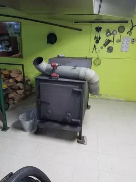

The top is 4' high. I took 20 or so gals of creosote out of the chimney

Damn that's a beast. Galvanized stove pipe?

Kool pictures simple looking stove!

20 gallons of creosote is hard to believe. They are very lucky that stuff didn't catch on fire. That's a lot of fuel.

Sadly 10+ gals is not that uncommon. There is one place we take 20 to 30 gals out every year. The most i ever took out of a chimney was about 65 gals. We now clean that place every year and get 15 to 20 a year.
The lady with this stove just got the house when her father died. We have been working on the stove for years but she just ordered a regency 5100 to replace this beast.

It has an insulated liner it meets all clearances it is just a rediculous stove that cant possibly be run clean. She already knew it needed to go
