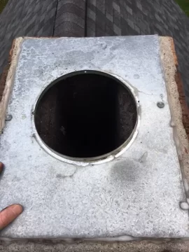

Hi I just removed a 4" liner from our chimney that was used for a direct vent lp stove installed in our house. We are converting back to wood and plan to use the existing center chimney and flue that appears to be in good shape. We are not putting a new liner in the chimney. When the lp stove and liner was installed they riveted and glued a plate cap on the chimney with an 8" round opening to attach the liner and cap to. I'm wondering if I can leave the metal plate on the chimney and put an 8" rain/snow/critter cap on it or if I should pull the metal plate off and put a cap over the whole thing (flue and masonry) like I see done in some applications.
Here is a picture of the plate for reference. Obviously I would rather leave it since it is riveted to the masonry but if not having the full opening or the glue up there is a bad idea I will take the time to pull it off.
Thanks!
Thanks!
