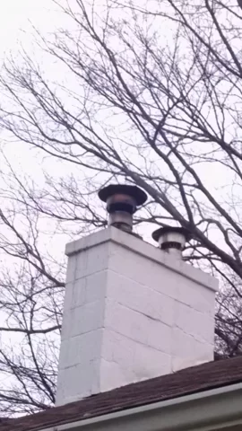

Hi. This is a recent pic of my chimney cap. I am new to woodburning was wondering if the dark color of the cap on the left in the pic is anything to be concerned about or is this normal. The cap and a new liner was installed in September.

It could be soot, but it's pretty dark. Personally I'd check it out while the weather is good.
For instance, were getting a 24" snowfall tonight. I'd hate to find out I had an issue then.

Take a flashlight up there, pop the cap off, and look at the cap and the flue. Good way to see if you need to sweep the flue, and you can get a better look at the cap.

You need to burn a hotter fire. If you do it will clean the cap up and it won't be as dark colored as what you have now. Don't be afraId to get the chimney temp to 350 to 400 deg as its a cleaner burn and no creosote will build up
It's pretty hard to tell from a small picture. Looks dirty, maybe from burning cool. Is this connected to an insert? Is the liner insulated?
Mine has similar discoloring but it has been over 2.5 years. I sweep my chimney 1-2 times a year and never see creosote.
If it rains, and the dark goes away, it's soot. Going up and checking for buildup is the only way I know to be sure you don't have creosote.
It's connected to an insert and the liner isn't insulated. I was burning cooler in the beginning because I was going by the stove thermometer which turned out not to be a stove top thermometer. I now burn 500-600. Sorry about the pick. Too cold and we now have snow on the roof to get a better picture.

I would get it swept ASAP, especially since you say you have an uninsulated liner and were running it cool for a while. Not saying for sure it needs it, but there is the safety & peace of mind aspect....
Do you feel comfortable looking down the chimney from the top? If so, see if there's any buildup.

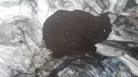

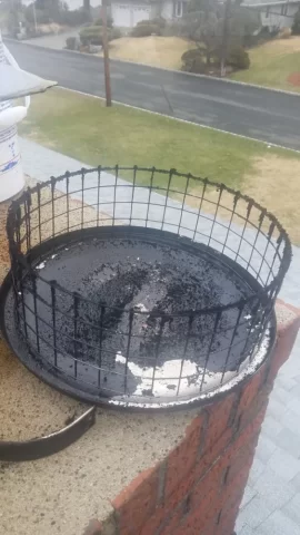

You can get a sooteater from rockfordchimneysupply.com. Clean from the top or bottom. From the bottom you will have to manage the dust. This is what mine looked like after 2 months of nightly burning. 5:00pm to 1:00am daily.

I don't think a hot fire will clean a cap. Unless it starts a flu fire.
Maple I disagree. You mean to tell me your stove never had a cool fire and created black soot and light creosote? Every stove has. What happens when you burn a hotter fire the black soot and light creosote gets burnt and cleans up. Are you a rookie in burning? Creosote is dangerous when it's caked heavy but when light it's easy to burn off. The poster even stated he burned cool which would agree with what I was saying. Again burn a hotter fire for a longer period and it will vanish
