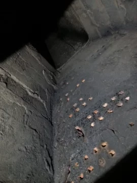

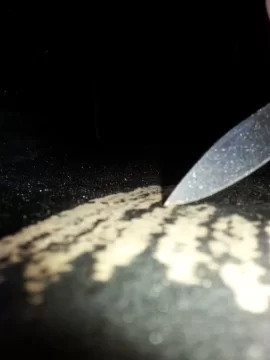

Just bough an old farm house with a nice old wood stove insert. I whipped a chain in the flue pulled the stove out cleaned that, then cleaned the flared out part of the chimney with a shovel. Filled up a contractor bag half way.
Had been using the stove with great results. Being new to burning inside i checked the flue from up top after a month of use.
After some reading i think i understand the black coating to be dangerous? That said i have stopped burning. What action do i need to take? Is it normal?
Thanks

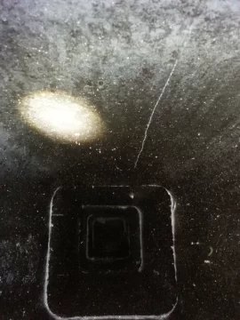

Two pics of my flue:

Looks like glaze is starting. That's not good, but good for you for stopping and asking.
What stove is this? Is it connected to the chimney or slammed in with no connection?

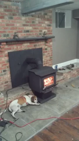

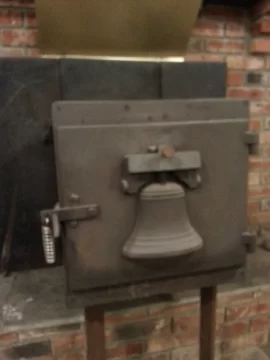

Ill add pic of stove. Any advice to diy the glaze away?

  • [Hearth.com] Chimney: clean/needs cleaned/house about to burn down!
I see A glazed chimney with atleast one cracked flue tile and a slammer install i would say that qualifies as dangerous.

The stove, the poor wood and the way it's connected are all causing the problem. Combined they make a dangerous cocktail. Glaze creosote is hard to remove. There are some products like cre-away that can help make it easier to remove but that may only be available to a professional.
Hard to tell from the pic, but it does look look like it's starting to glaze . . . combine that with a few other issues and I would be concerned with burning wood in the chimney as it is now.

Thanks for all the quick good info every one. What is apparent in the pic suggesting a broken tile? If its top section top of screen that was my knife.
I did read up on flue volume a little bit, and the taper on top of the would be fire place is were the bolk of the accumulation was.
So what is a solution to "slammer" problems? Could i plumb some 24ga from the stove output to the flue? Maybe clean point up the masonry, then run a steel pipe up?
I would love to get the thrng running agan.
But.. if it will end up costing more then 340$ i will call the oil man and save it for next years problems. Hoping to get it running safely though.
The crack running down the tile in the second pic.
A stainless liner from the stove to the top of the chimney. And yes it will cost more than $340
Reactions: Stevenmverrill
An insulated stainless steel liner will make it safe. It will need an adapter to connect to the stove. The cost will depend on the chimney height. That doesn't solve the damp wood issue... Oil is cheap this year and that maybe the safest bet if there aren't funds to make this right. If that's the case, stack the wood with the top covered so that it seasons properly for next year.

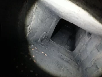

Desided to get some pic's looking up. And some thoughts on what you all see.
I was thinking about an exhoust on a car. Yea if you clean it it will be clean for a day or 2. But, it will get coated in soot in no time.
So... is a sooty chimney nor

So how do you tell the difference between soot and creasot? Or is the soot not normal? Thinking back to my childhood is why im trying to shed more light on this. I recall all fire places being covered in black. Some pic's of a safe flue would help me a lot.
Scaning this place i have seen much more build up getting called time to clean.
Soot contains creosote but what is typically called soot is much lighter and much less flammable than the typical gooey or crusty creosote. But regardless of that your install is unsafe. It is a slammer in a chimney with cracked tiles and open cores in the smoke chamber any one of those problems should be enough to not use it but the combination is scary.

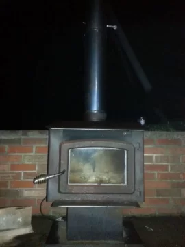

Looks like no inside fire for me this year:-(
But, i do have this for outside :-)

Other then the being a slamer. I think the inside one is nice. When i was using it with good wood i could get a smoke free chimney. And loading 30" logs is nice.
The outside stove is nice imo but is small. I picked it up for 100$ and do not mind it getting rusty. It works well and is safer then a fire pit.

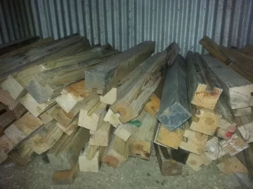

On good fuel: what are your thoughts on pine? I work for a flooring company and can get about pickup full of pallet stays a week. Sticking my moisture meter prongs in them they are 10-20% now. I have a section of my shed i can fill with them for next year.
See pic what you think? Note i know they are not treated the ones that get left out quickly turn grey, and have used them at bond fires with no abnormal smell or smoke.
Nothing wrong with pine at all aas long as it is 20% or less. It has much lower btu content than hardwoods and it will burn fast but it will burn and make heat

Don't burn that pine until you made your setup safe with a liner at the very least, Dry pine is a good wood to use (many of us burn it during the fall and spring months) Pine has a tendency to burn hot and fast, that combination in your existing setup could prove failure for you and your house with a chimney fire. The hot all at once flue gases could lite the existing creosote and the cracks in your masonry could lead that fire to the structure of your house.

careful with the pine 4x4 you plan on burning. the green ones look like pressure treated to me. if you burn pressure treated it lets off poison gas
