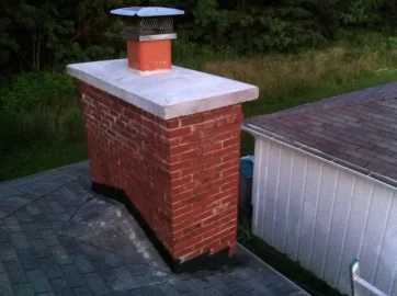

Crown coat is a great product as long as the cracks aren't too big! I was trying to decide if I was gonna do a stainless cover, a crown coat or just pour a new concrete crown. Mine was mortar like most and that is just no good. Most masons just slope some mortar up there and that's no correct, it should be cement. And there has to be an expansion joint between the flue and the crown. If you don't have an expansion joint or an overhang I would consider just pouring a new crown. Mine is 6'x almost 3', it cost me $45.

Why such a big wide chimney for just one pipe? Visual effect or was there another pipe in there at one point? The single pipe looks lonely on the big crown.
It's a fireplace. Only only flue in it.
