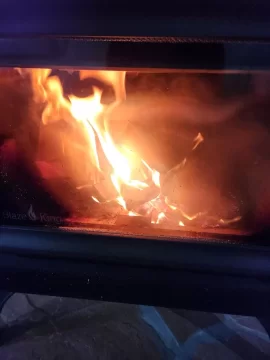

Got key damper installed. .15 WC ish on not a full load. Only 3 splits to get some coals. 47° outside. Shut down key damper all the way and best I can turn it down is .1-.12, thoughts? @Ashful , how are you keeping your WC in range with your .21 draft?
Here's some pictures that should all be in order from startup.
But just to be sure we're on the same page, you can only measure draft with bypass closed and running on high. As soon as you turn down, restricting inlet air, the draft will climb.
I think this is to be measured under steady-state condition, with the stove, thermostat and flue at whatever temperature they stabilize after sufficient time. Once set, I can run my stove thru a full load on high, and it doesn't typically drift at all. I certainly don't go thru any effort to try to time it before the stove heats up.This is the one time that the BK thermostat can burn you. It will self close as the stove heats up which will throw your draft number higher. So you really need a hot flue but a cold stove which only occurs for a short time.
Then realize that draft strength will change as the burn cycle goes on but the spec is to set it at high burn.
