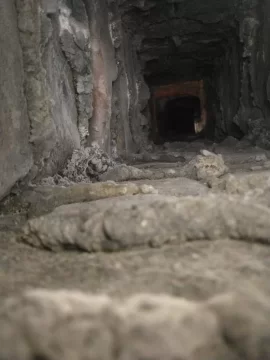

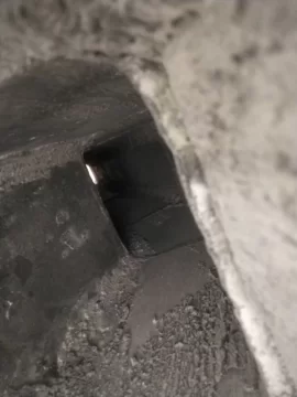

This was the combination of problems that led to my chimney fire:
No clean out door. I had been faithfully cleaning the chimney and brushing all of the creosote down to floor level and not under the house. When the chimney sweep started mucking out all of the wet creosote, he estimated 10 or 15 lbs.
The 8-in clay liner was only at the top 10 ft and the rest was rough masonry without a smoke shelf.
The clay liner was 8x8 inches --and it wasn't going to be possible to install an insulated flex liner no matter how much I wished it.

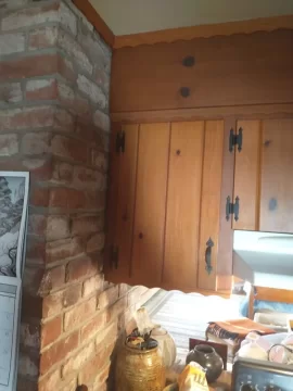

Clearance to combustibles was a total failure. The kitchen cabinets were bolted to the rear of the masonry. At the rear of the brick chimney, the center bricks were only one brick thick. There was some obvious pyrolysis happening with the kitchen cabinets.

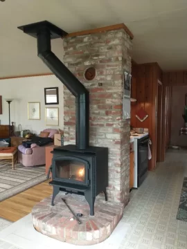

The solution came at a hefty price tag for the littlest Lopi Answer. Because my new stove would require chimney pipe up through the kitchen roof and up through the attic with 2, 30° offsets. $5800 all said and done.
The stove and I have become fast friends and she is doing her job of heating my kitchen and dining area. The little lopi will not heat my entire 1000 ft house, 1969 construction.

I discussed every possible way of remediating my chimney. No one was willing to break out the clay liner! And even if I found someone to go down that road, there was a 30° offset running towards the masonry thimble. In addition, there was not the requisite clearance to combustibles where the kitchen cabinets and bookshelf were anchored to the chimney (See pic). The only thing I could have done would have been to tear down and rebuild the chimney and that would have cost me a lot more than the final "Answer".
IMG_20220108_092339865_BURST000_COVER.jpg IMG_20220216_080213649.jpg IMG_20220108_103404879_BURST000_COVER.jpg

It's a challenge when you can't find someone to do the job. Wood against a chimney is not that uncommon; usually, it's structural. An insulated liner gets it down to zero clearance.

I think you made a good decision. Simple, reliable, serviceable and while not cheap, good work and products often aren’t. Sure there are probably other ways but nothing wrong with this way.
