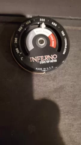

Thank you! If I use the stove with bypass open I still need to get the temperature up to 600 degrees? I have moved the stove top thermometer from the middle of the griddle to the back of the stove, centered in front of the pipe, correct?
Dauntless owner's manual says to place the thermometer in the middle of the griddle. FWIW.
If your not going to close the bypass you dont neet to run the stove at 600... and I wouldn't put a lot of wood in it neither.. some small splits and just let it burn, cut the air to no more than half way and it should burn clean.. Burning with the cat will allow you to get the most out of the stove by being able to turn it down when less heat is needed. You only need to heat the stove up to operating temperature if your going to try to engage the cat.. if your going to use the catalyst.. install the Auber AT100 and 6in thermo coupler.. its digital and gives you exact catalyst temperatures in real time.. the bimetal thermometer sucks and is a slow read below is magnetic thermometer placement.. 2nd pic is my cat temperature

Thank you Woodsplitter! Plan on getting the Auber and thermo coupler as soon as possible! I have read so much good advice on this forum and am grateful. I only wish I found this forum before I bought my stove. Will call Applied Ceramics tomorrow to see if and when the combustor will be available. I am bound and determined to make this stove work for me. Luckily I live in a more temperate climate and shorter winter than most, just would be nice to save on electricity!
That is true, but have read through some good advice on these forums and someone suggested the best place to place the STT is centered on the stove just in front of the collar and flue pipe. (found the author)

For what this is worth coming from a guy with a non-catalytic VC Dauntless, the white smoke is as you said a clear indicator of a lack of temperature within the stove. This is usually due to an insufficient coal bed. Starting from cold with an inch of ash throughout the entire bottom of my firebox, it takes at least 45 minutes to develop the uniform stove temperature and depth of coal bed to be able to close the bypass and not have white smoke form. In my previous VC Intrepid it took 30 minutes to effect the same. I would guess to say that it will probably take an hour for your Encore to reach the same conditions as it has an even larger firebox surface area and has yet more cast iron mass to bring up to temperature.
Furthermore, while the quality of the coal bed is essential for these stoves to operate properly, it is equally important that the coal bed and particularly the ashes not block the lower back firebox outlet and secondary air inlet ports as it can restrict or entirely block off the flow of exhaust gases and secondary air to the catalyst in your case (and the secondary burn system in my case) and cause white - low temperature - smoke to form.
You may find your local VC dealer immensely helpful in getting your stove to perform for you as he/she presumably knows the wood type and the stove very well and can look over your exact setup to see if anything is incompatible with the proper operation of a VC Encore. Early on in my experience with my Dauntless, my VC dealer said "In general wood burning is an art rather than a science and a Vermont Castings will especially bring meaning to that statement. Good thing you bought a Dauntless cause you'll need to be."
A very helpful tip my VC dealer gave me was to place the stovetop thermometer centered between the rear of the cast iron griddle/lid and the front of the flue which is in contradiction to the placement specified in the manual. The reason I was given for this change of placement is the temperature usually is higher there and also is usually more indicative of the general heat within the main body of the stove as the cast iron is considerably thicker there than compared to the griddle/lid.
