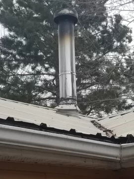

Have a chimney that is around 25 years old,how do I identify if it is selkirk or gsw as no stickers on it,will there be something stamped on the chimney?
Sometimes it is stamped on the chimney. Otherwise it can be hard to id and may be discontinued.
Thank you
Here is photo
  • [Hearth.com] Chimney identification
Took it out and stamped gsw on the inside
