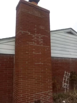

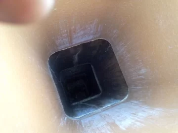

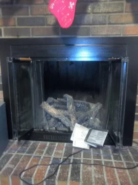

Hello, I have a Monesson hvfl24nv gas fireplace and i was told that my chimney needs a new liner. Is a liner required for this fireplace? I don't know much about it..
Thank you.

Your unit is a non-vented (nv) Gas Log Set.
No liner is needed, but it IS advisable to vent this product.
