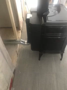

    I am also wondering if the air intake is an issue. The 4" pipe comes in through straight then at the back of the stove it has a saddle bend before it enter the underside of the stove. This to be represents two 90 degree bends as it were. Is it possible that this is also restricting the draw of air couple with a potentially short flue height?

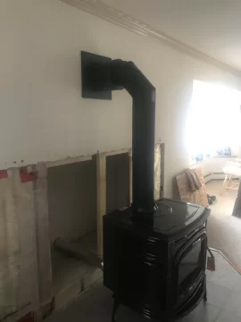

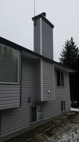

    Hope these photos help. Note the air intake pipe has a saddle bend in it, not just one elbow.

  18. maple1
    maple1
    Sep 15, 2011
    9,445
    1,899
    Nova Scotia
    The copy of the manual I found on line said minimum 15' from top of stove to chimney cap, in the spec section on page 5. That's before adding the extra required for elbows, horizontal sections etc..
    So ya - you are quite likely too short.
