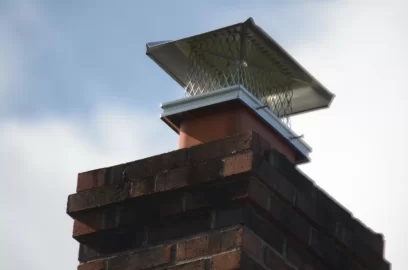

I am in the mid planning stages of my soon to be purchased insert and have a question. The picture below is of my chimney cap, it sits about 35' off the ground and I do not have a ladder tall enough to reach it to measure the size. Picture is with my telephoto lens.

My concern is that it looks to be an 8x12 liner (can the experts confirm that size please), which would then require an oval stainless liner to be installed. I plan on installing the liner myself, which would require scaffolding to be set up and anchored for safety.
Do I remove existing terra cotta and use the cheaper round liner or leave the rectangular terra cotta and install an oval liner?

That is an 8x12. Wether to remove or not in this case would come down to condition. You said you had a fire so they are probably cracked already. Which in that case i would remove them. If they are in good shape and can be cleaned properly i would leave them so the fireplace could be returned to use later

The 8" x 12" is the size of the outside of the clay tile, inside is probably closer to 6.5" x 10.75", they all very so that's just approximate.
A 6" Flex liner is about 6.25" OD and adding a 1/2" Blanket wrap will add between 1" to 1.5" because of the insulation over lap. There is also Pre-Insulated liners -, 7.25" on the outside.
Adding an insulated flex liner will require removing the Clay Tiles, to make room for the liner and insulation.

You are right for a round liner but oval will fit
I know an oval will fit. My question would be "is it better to remove the clay and install a round insulated liner - or leave the clay and install an oval insulated"? Of course every installation is location specific, just wanted to gain a sense of what is most typical.

Read my first post most of your question is answered there. And no it would not be permenantly limited to an insert you could always line it for a fireplace again. But that isnt cheap which is why i said if the clay is in good shape leave it. But if you had a chimney fire they are probably cracked so it would need relined anyway. If they are cracked i would remove them and put round in
