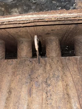

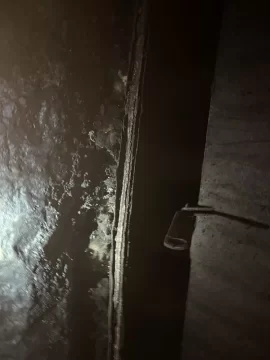

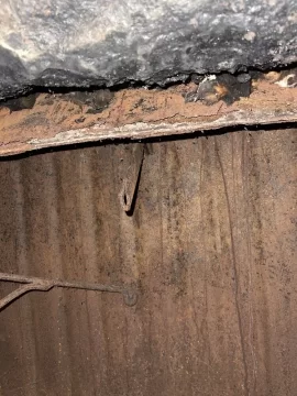

Hello, from the photos I have attached. Would it be possible to install a flue liner into this old heatform firebox or is it too rusted out? You can see the piece behind the lintel stone is falling to pieces.
[Hearth.com] Chimney liner in Heatform [Hearth.com] Chimney liner in Heatform [Hearth.com] Chimney liner in Heatform
Reactions: MEngineer24
It doesn't matter if it's rusted out if you are installing a stove or insert and liner

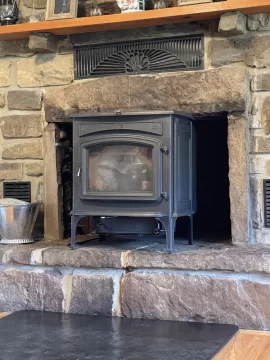

Well it’s finally complete. Very happy with the new setup. Just waiting on the mantle shield now.
