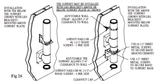

My current issue is with mounting the chimney support, which is braced by triangle brackets that sit below the T-junction of the chimney. Given that it is supporting the weight of the entire chimney, I'm not happy about having foam between the support and the structural pieces of the wall. I am planning on removing a huge piece of foam, finding the studs, screwing 2x4s across the studs, building up to flush with the furring (an extra 1 1/4 inch: 1/2" ply + 3/4" lumber) and then mount the support to that.
Can anyone offer confirmation that this is a good idea, offer alternate ideas, or give pointers or tips that will be helpful during this process? It's too late for photos right now, but I can post some tomorrow if it helps. I've got the siding off the house in the relevant areas.
