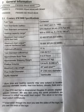

I have a Century FW3000 that I bought @ Menards. 2.4cu. ft. firebox, it’s ash box is roughly 11”x13”x5”. I am heating 1250sq. ft. single story built in the 40’s, with no wind break to the north or west & it has no problem keeping it warm. It will take 16” chunks in a N-S loading.

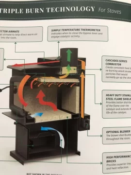

I looked at the regency 2450. I’m sure it’s a fine stove, being the evolution of the proven 2400. I don’t like the round cat you slide directly under the flue collar. I realize there will still be benefits of the cat vs no cat at all, but talk about sending the heat up the stack...
Can you clarify what you mean by round cat? The 2450 is a tube stove as far as I can tell.
Yeah sure, it is their “cascades with eco-boost triple burn technology” line, a.k.a. A hybrid stove with a cat for cleaner emissions to meet epa 2020.

like I said I’m sure it’s a fine stove. The cat would certainly help keep temps up for a clean burn.

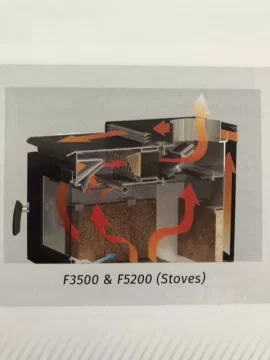

See my pic above for the new adaptations, and these are the existing stoves, well the newly tested versions of the existing
Way more chance for the cats to radiate and deliver some heat to the stovetop I’d say
