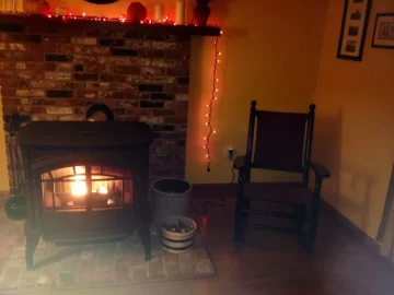

Can I place my real Christmas tree next to my stove where the rocker is in this pic? I feel like that may not be safe but on the other hand, it's the coolest part of the room. Thoughts?

Most pellet stoves require only 3" clearance to combustibles. As long as the stove stays at least 3" away, you should be fine.
That poor tree is going to dry out very very fast. Treat accordingly. Nothing sadder than a before X-mas fire.

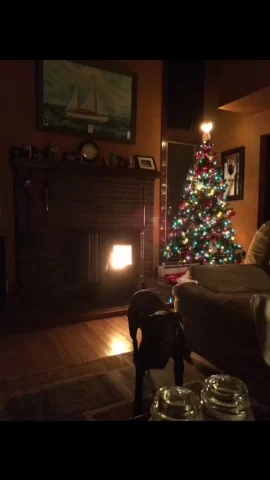

[Hearth.com] Christmas Tree Placement I put mine along side of it but with the old wood stove I grabbed one of thoes $300 fake ones still using it... Not as nice as the real thing though.. I think you could be ok just get a balsm fur they don't shead as bad and hold the moisture better

Could place a piece of wood-plywood or the like against a chair by the tree to help shield the tree from heat when not enjoying it.
Already thought of that you can't see it but there is a piece of fishing line tied from the top of the tree to a small nail in the wall... Did that with the wood stove last year plus when we're not home the animals are in a crate

After a couple seasons with a real tree, we realized that no matter how much we kept it watered, the heat from the stove sucked the life out of it.
Created a huge mess since it dried to a crisp.

Ever seen a dry conifer burn? They go like a torch. because the pitch in the branches and needles isn't dried out, it's a flammable gummy substance. I'd opt for a fake tree or put in another room, away from any heat source. One spark and your house is gone.....

I ordered a fake tree this morning. Ugh. I personally hate fake trees but I'm not willing to give up the pellet heat for a month and would like to enjoy a tree in this living room. I'm not concerned about the heat since that's the coolest spot in the room. More concerned about the dry air and if I put a live tree across the room from the stoveI think it would get even more dry with the hot air blowing that way. When there was a crappy wood stove in that location we just didn't use it during the holidays. I guess it's worth the trade off to get a fake.
