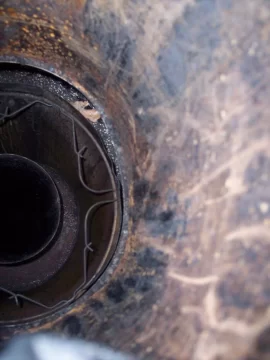

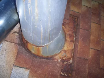

We have been using Englader wood stove in mobile home since 1993. Husband passed away 2007. Last year I replaced the chimney pipe as it had totally deteriorated. Ace hardware sold me a single galvanized pipe to replace it. I read that I need class A pipe but will i have to replace the ceiling box? I have no idea of the connection type there. pictured attached. will the class A just go through the chimney box? The pipe is 8 inch and I just found a DuraVent DuraBlack 6 in. to 8 in. Single-Wall Chimney Stove Pipe Slip Increaser can i stick that in there and add class A chimney pipe. Replaced the interior stove pipes.
Any advice is appreciated.

Where is that pic taken, looking down inside the support box?

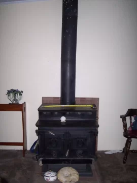

I think we need some more pictures of the current stove and the current piping to determine the right solution.
I'm not sure what I'm looking at, but it scares me! You do need class A chimney pipe, and in a MH, double wall stovepipe.
You can't mix different brands of chimney, they are systems that are designed to be used together and they shouldn't be mixed and most often can't be mixed because it would fit together anyway. If you can get a pic from the inside we might be able to tell you what brand it is so you can reuse the ceiling box.
Englander- 6" pipe. Your best bet is to replace the flue system with one from a single mfg. as stated above so all the pieces fit together properly. Double wall from stove to ceiling adapter /pass through then triple wall stainless from there up. This how I set mine up and never had a problem. It also sounds like you will need to hire out to get this done. So check your yellow pages for stove shops or sweeps that can do this for you. I'm thinking should not exceed $1200 dollars including labor maybe less,I do not know the current pricing of flue parts as it was some 10 + years ago I installed it in my trailer.
You stated 8" pipe that may have been the outside dimension of double wall, the inside would be 6" to fit the stove, the triple wall will be about 10" or so outside diameter and again 6" inside. Galvenized pipe has no business in a flue system, and you should not be using single wall inside the trailer.
The picture is from the roof right after we discovered damage. I just realized , Blades, that you are right. I need to run new pipe from stove through ceiling so they will connect. Why dont home improvement stores know this arghhh. Stove pipes are 8 inches from stove through. Gee thats a LOT of money. I hear you so is the house.

How bout that picture from below? The ceiling box might be re-usable.

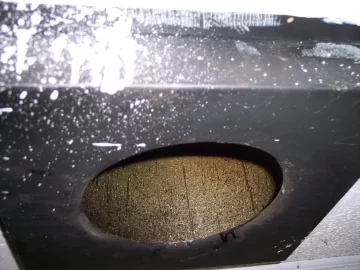

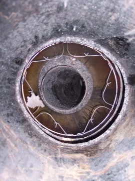

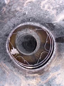

will try to get pic from inside thru ceiling box. thanks again for advise.
cant belived we used it like we did for SO many years. tempted but wont. Propane is TOO expensive to heat a home especially with all the free fuel i have.
I have gathered pictured from ceiling box top and bottom. My pipes connect to each other through the ceiling box, Which was the wrong way but would like to fix this with out changing box.
I possible. Can any one advise. pics are from chimney box to inside box going up then chimney and going down. Thank you.[Hearth.com] Class A chimney pipe[Hearth.com] Class A chimney pipe[Hearth.com] Class A chimney pipe[Hearth.com] Class A chimney pipe
