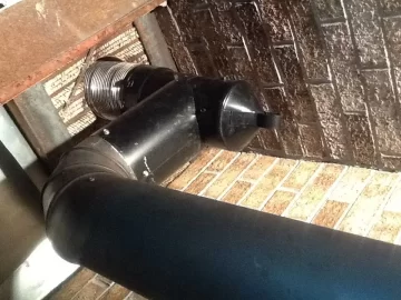

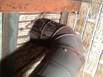

Yes, I will be purchasing a wood moisture meter. This year for the first time, I have 2-5 year seasoned wood. Any suggestions for a collar or thimble where the pipe goes up to the chimney? Right now it's just shoved through. [Hearth.com] Clean Chimney...[Hearth.com] Clean Chimney...[Hearth.com] Clean Chimney...[Hearth.com] Clean Chimney...

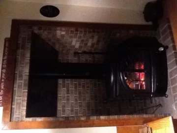

You may have better luck on an answer in the wood stove section of the forum. Looks like a very nice stove!

Your chimney needs a full height stainless steel liner, and a proper connection to the appliance and a properly constructed/sealed block-off plate where it looks like it's just jammed through...through what? What is that thing that looks like some sort of filter element? I'm assuming all these pics are sideways, so that means the stove pipe goes vertically up from the stove, takes a 90° to the rear, then another 90° to get jammed up into the flue through whatever that thing is...is that correct? There's some serious fixin' to do here to make this a solid, safe, efficient, maintainable installation. Rick

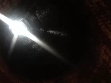

hard to tell does that flue run straight up from that elbow? if so it should have a tee on the bottom not an elbow. But that would not cause more buildup. First how is you wood seasoned? Is it cut split and covered for that long? If so it should not be a problem with the wood. Is there anywhere that air can get into that flue? What size is the flue? I though it looked like a 7 by 7 but hard to tell how tall is it we need more details

This is a vertical rise in a rather massive hearth 7' high. What looks like an "element" is a concrete and wire mesh that a metal collar sits up inside to the tile lined chimney. The stove pipe comes off the top at the rear of the stove and I have a couple of 45's to the chimney that is offset to the right of the hearth. Long story short, I'm getting a quote for a liner. I'm guessing flex with some sort of cleanout. Thank you for the replies. Learn lots from you folks (with some humility on my part).
Low and behold, my mason was next door today giving a quote on another job. got a quote to replace chimney crown, install 25' stainless, cap and inside "T" with cleanout for @$1200. Feeling better about this!
Sounds like a decent price just make sure he knows what he is doing when it comes to chimneys many masons don't. He might be very good but id check
Ageed. He's a local guy with a great reputation I have used before. Including the mason, all that view my hearth agree it's one funky unit. I half think that it started out as a fireplace and they changed their mind. It also has a massive base to it in the basement.

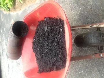

Wow, that looks like a lot of crud from your chimney.
When was the last time it was cleaned?
Yea thats a bit scary. I usually measure my creosote in ounces in a 32 oz folgers coffee can. And even then I can fill about 1-2 cans every 3 months which seems to be a bit excessive imo. I can't imagine measuring my creosote in wheelbarrows...
I clean annually and for me too, this was a bit much. I have issues of draft and perhaps burning not so dry wood. To address both for safe and efficient operation, I am having chimney flex installed and I also purchased a moisture meter.
It takes a while to learn your own stove, I have decided to sweep every 2 cords (probably over kill), for me this means sweeping halfway through the winter, cheap insurance!
Actually, I cleaned 2x per season as well. Last season however, I got the pellet stove in March and got lazy on the second cleaning thinking I wasn't burning as much wood. the new liner will have a cleanout so should be a breeze this season. Before, I would have to move the stove, pull the pipe and get on the roof.
Well, the liner and T connection is in...also have cleanout. This is a vertical rise for a hearth, kinda weird but put in this way when house built.

That looks great, and should make cleaning from the T up a snap!
How will you clean from the stove to the T?
