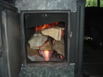

Clean glass door often and burn a lot of wood?

If your chimney meets the minimum spec and your door glass is getting dark then you either have a leaky door gasket (unlikely) or are burning wet/green wood which is very likely your issue. You can't force this stove to burn dirty unless your fuel is improper.
These modern stoves like full fireboxes of small split wood. Like 4" splits which is much smaller than most people realize. Keep shoving dry small splits into this stove in full loads and turn down the intake air as soon as you can while not snuffing the fire and you will get a hot and clean burn that will keep the window clean.

Thanks highbeam....think I have been putting in to big of pieces and at times chocking the fire. BOY HAVE I LEARNED A LOT TODAY!
