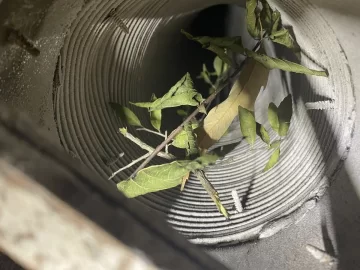

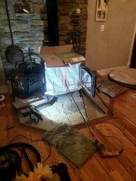

Last night I decided to sweep my chimney since it's looking like it'll finally get cold enough next week to have our first fire.

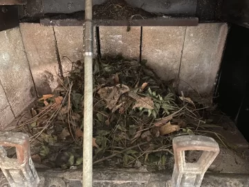

After I removed the tube assembly and the baffle plate with the ceramic blanket, I started getting suspicious. There was a twig at the very bottom of the liner. Long story short, I ended up pulling down a squirrel nest and 2 baby squirrels. Just about filled up a 5 gallon bucket with leaves/twigs/etc.You absolutely could not see this from the ground. This is an exterior chimney roughly 30ft tall, so I'm not up for getting a ladder out and climbing that chimney.

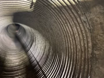

The chimney itself was really clean just like last year, but I sure am glad I decided to sweep it anyway. Really pleased with how the liner looks after sweeping it with the chimney.

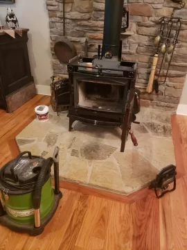

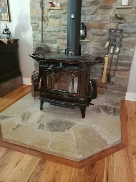

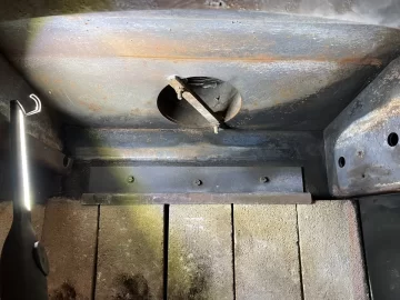

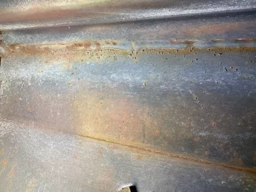

Also looked over the insert to look for cracks etc. Luckily everything looked good. I also took some pics of the welds. This is a quadra fire insert, I'll let you guys judge those welds...

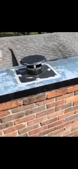

You need a better chimney cap!
Agreed! I had a new chimney cover plate put on this year. I asked them to replace the cap since I was afraid something like this may happen. They refused, stating that what I wanted to put on (just a classic square cap with mesh on 4 sides) was going to restrict draft too much. I said it would not, but they said it would and I did not want to argue so I left it at that.
This is the cap I have now. The cap can be taken off and be replaced with something better, right? I'm not sure how the liner is held up top.

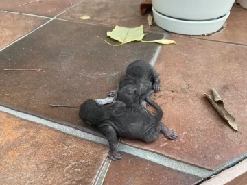

I don't want to know what would've happened if I made a small fire first. All that material was extremely dry. It either just wouldn't have drafted and smoked out my living room (best case scenario), or there would've been a heck of a chimney fire
Liner is held by the square top plate. Should have a pipe clamp. Cap is then attached to the round part of top plate.
I should've mentioned, squirrels are alive and well. Made a nest for them last night and gave them goats milk. Their mama came back for them last night and got them.
I gotcha. When they put the new chimney cover plate on they took the square plate off. I wonder if they used a clamp or not. Either way the liner is all the way up for sure so I'm not too worried about that.

Those are made to secure to the outside of the clay tile flue that usually sticks above the crown. I’d probably go with a screened round one.
