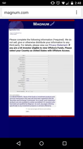

Hi Heather you can get the parts right from Magnum.com here is the part number for a kit. RP2091
Are you sure www.magnum.com is the right website? This is what I get when I go to that website (attached image)

That is the website I was thinking but I didn't want to assume. We also use east coast hearth but they really screwed us on our last order and we ended up paying considerably more for a part that we could have purchased cheaper elsewhere. It ended up being $68 more than noted on their website. :-(
