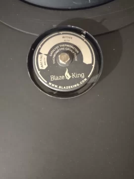

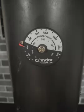

Just now at 700 with no smoke.
@RustyShackleford
I would try to dial down a bit later and in smaller steps.
That's what I think (...) I have to do with mine.
Sometimes I go a bit too fast (i.e. as fast as I could initially), and I see the cat gauge not increasing but slightly decreasing. If I look then I can sometimes see some smoke out of the flue. Dial up to get some robust flame for a couple of minutes (the cat generally starts glowing then - presumably because of the heat from the firebox/flame), and then dialing down in smaller increments works for me; the cat gauge goes up even when the flame does down (as it should). And the smoke is then gone.

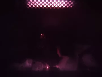

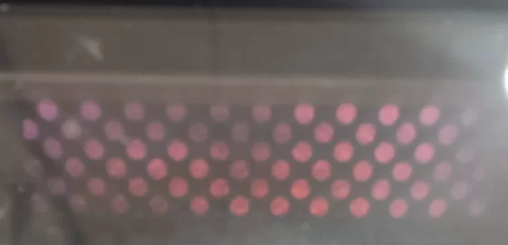

This is my current state. Black box when the light is on but some glowing when it is dark. Cat glows nicely though (not as bright as it seems in the dark; just a nice warm orange).
This is 2 hrs and 15 mins of a load of about half red oak and half pitch pine.

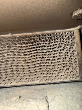

I can get another photo tomorrow, if needed... but Hearthstone 8024. 1.5(ish) years of burning, have never cleaned the cat.
What are your thoughts on the cleanliness of this cat? does it need to be cleaned?
- I generally burn doug fir and larch. Sometimes a white pine gets thrown in here or there but it's 90-95% doug fir/larch
And if it needs to be cleaned, is it "clean it now while you don't freeze during cold spells" or "clean it whenever you next get a chance. If you're not seeing drastic reduction in burn times/heat output, there's no worry"

If you can see through the channels (they're not blocked), I'd vacuum it. Vacuum it anyhow. If channels are blocked,. maybe that clears them.
Doesn't seem coated other than with ashes.
Looks good to me.
I wouldn't bother with a vinegar rinse.
